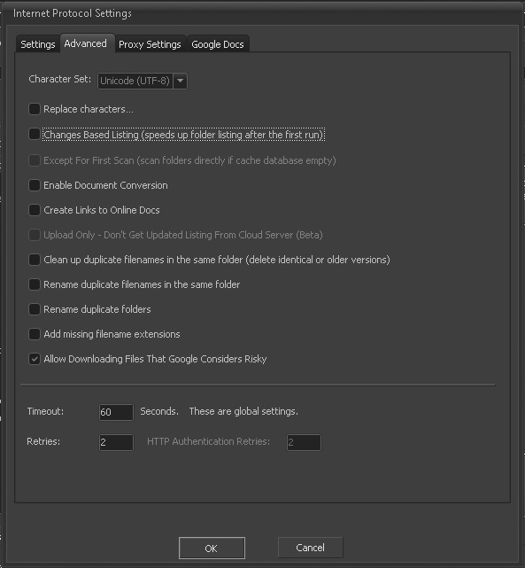

I've specified a subfolder on Google Drive, but when I run Profile, it scans the Change History in the root folder (\) first before scanning the specified subfolder, which takes a considerable amount of time. Is there a way to make it scan only the folder I specified (ignoring the root folder \)? I've looked in Profile Settings but there doesn't seem to be such an option?!
Re: Bypass the error "Abusive file cannot be downloaded from Google Drive"
the history is always global.
But you can disable history processing entirely for the profile.
To do that, you can click on the Cloud button and remove the following checkmark on the second tab sheet:
- Changes Based Listing

I turned off the "Changes Based Listing" option as you suggested:
Changes Based Listing.jpg (61.57 KiB) Viewed 305040 times
But when running Profile, it still processes the revision history at the root path. I can only use the Skip option to have it process the history at the subdirectory path I specified.
I don't really think that is possible. Maybe you are confusing profiles, or the job is still running and using old settings.
Make sure you stop it completely so it reloads the new settings. If you are using real-time, stop the scheduler too and restart it.
If problems remain, please send a log file to support@syncovery.com.

This issue appeared after adding an account and running Profile for the first time (even with Changes Based Listing disabled before running Profile). Subsequent runs of Profile will seemingly no longer present this issue; it will still display the path as / but will directly jump to read the subdirectory I specified.
I really can't produce any such behavior here. If it's OK now, I need to consider the case closed.
Syncovery may have to scan parent folders to get the folder ID. But that's not the complete history.
