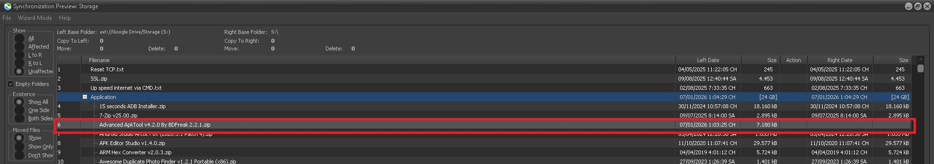

UPDATE: I discovered the problem. Syncovery created and selected a folder with the same name and path (I don't know why). After pointing back to the correct path, it compared normally.
The "Allow Downloading Files That Google Considers Risky" option also worked fine; files that previously couldn't be downloaded (due to Google flagging them as virus-infected) could now be downloaded normally.
But there's another problem: Files that are only on Google Drive but not on the drive are marked as Unaffected by Syncovery (see attached image). I deleted all the files in the Database and Logs folders, and only then did Syncovery detect that it was Affected.

Re: Bypass the error "Abusive file cannot be downloaded from Google Drive"
the SmartTracking mode ignores deleted files by default. So your file that existed only on one side was considered a deleted file that should be ignored.
You need to click the Configure button for the SmartTracking mode and choose what to do with deleted files.
If you don't need to mirror deleted files, you can use "Standard Copying" instead. Standard copying always copies, never deletes. And it does not depend on a database.
