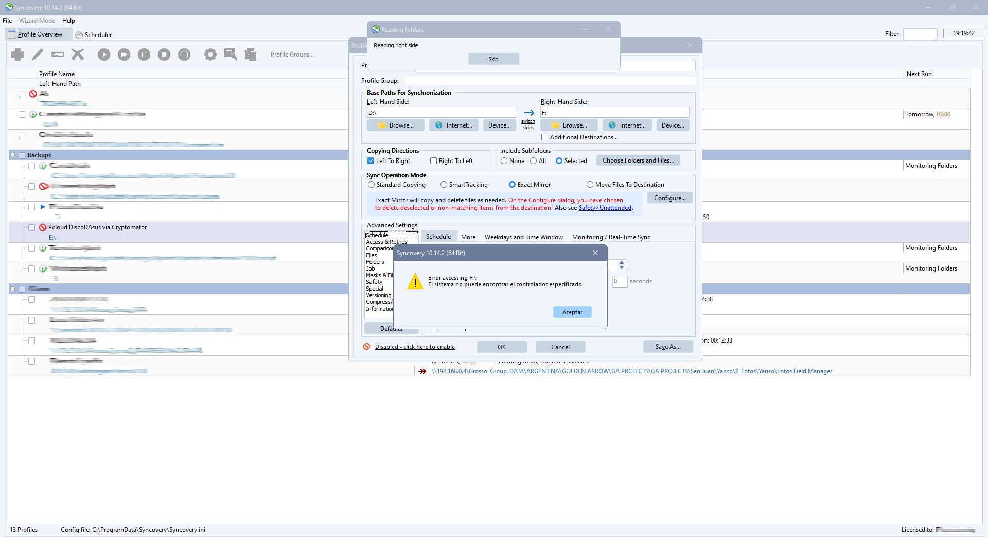

Cryptomator virtual drive unit is F:

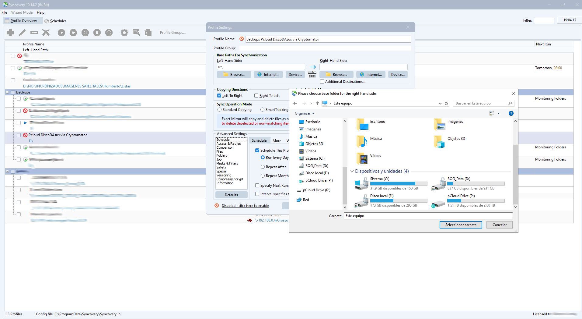

This is what I see when I browse right side (note F: missing here):

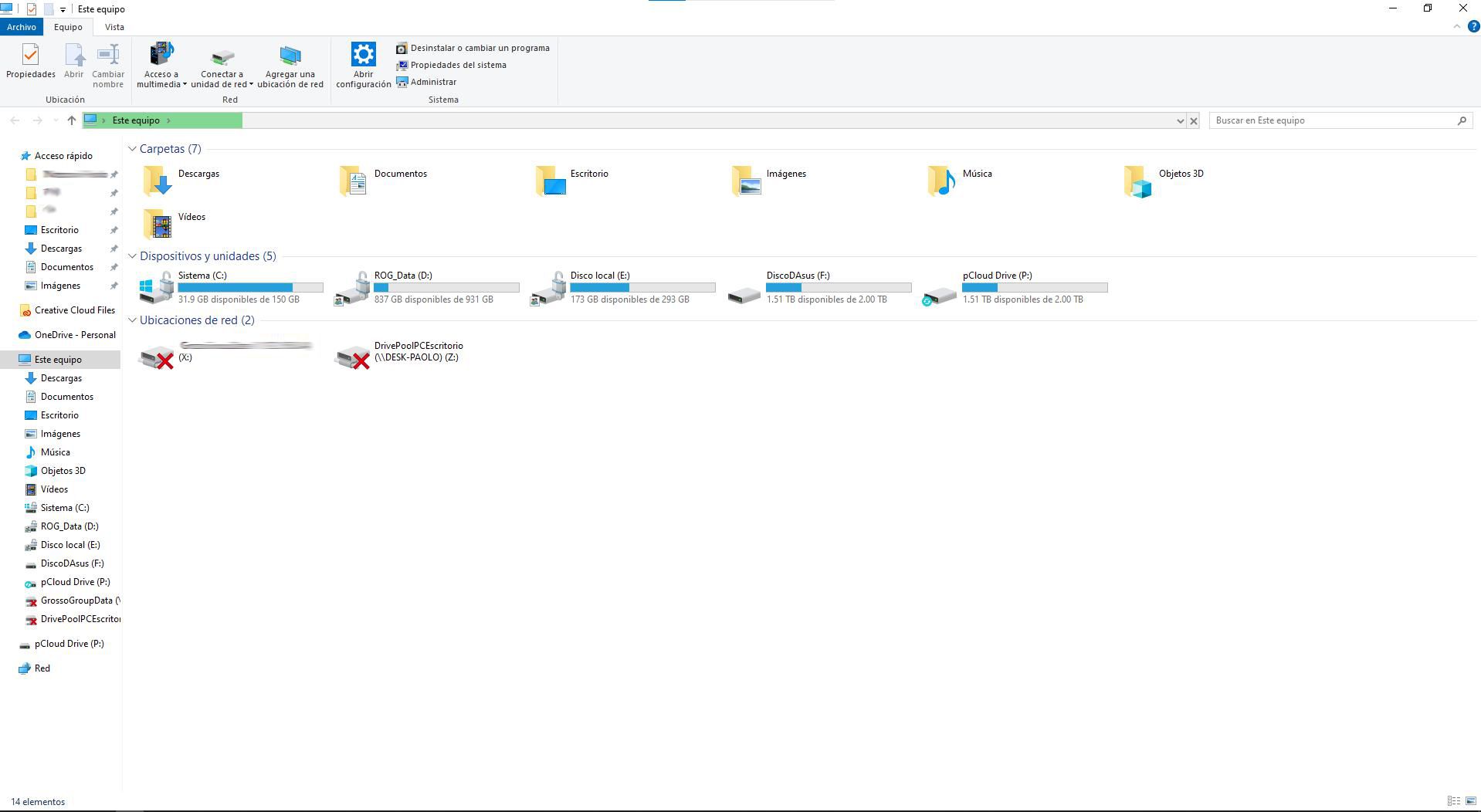

This is what I see in windows Explorer:

This is what I see if I just write the drive letter (F:) and try to select specific folders

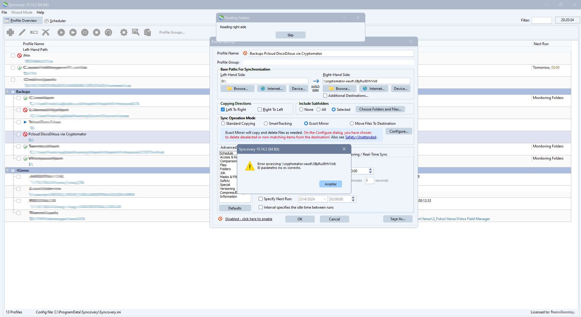

This is what happens when I try to select folders using cryptomator as a network drive:

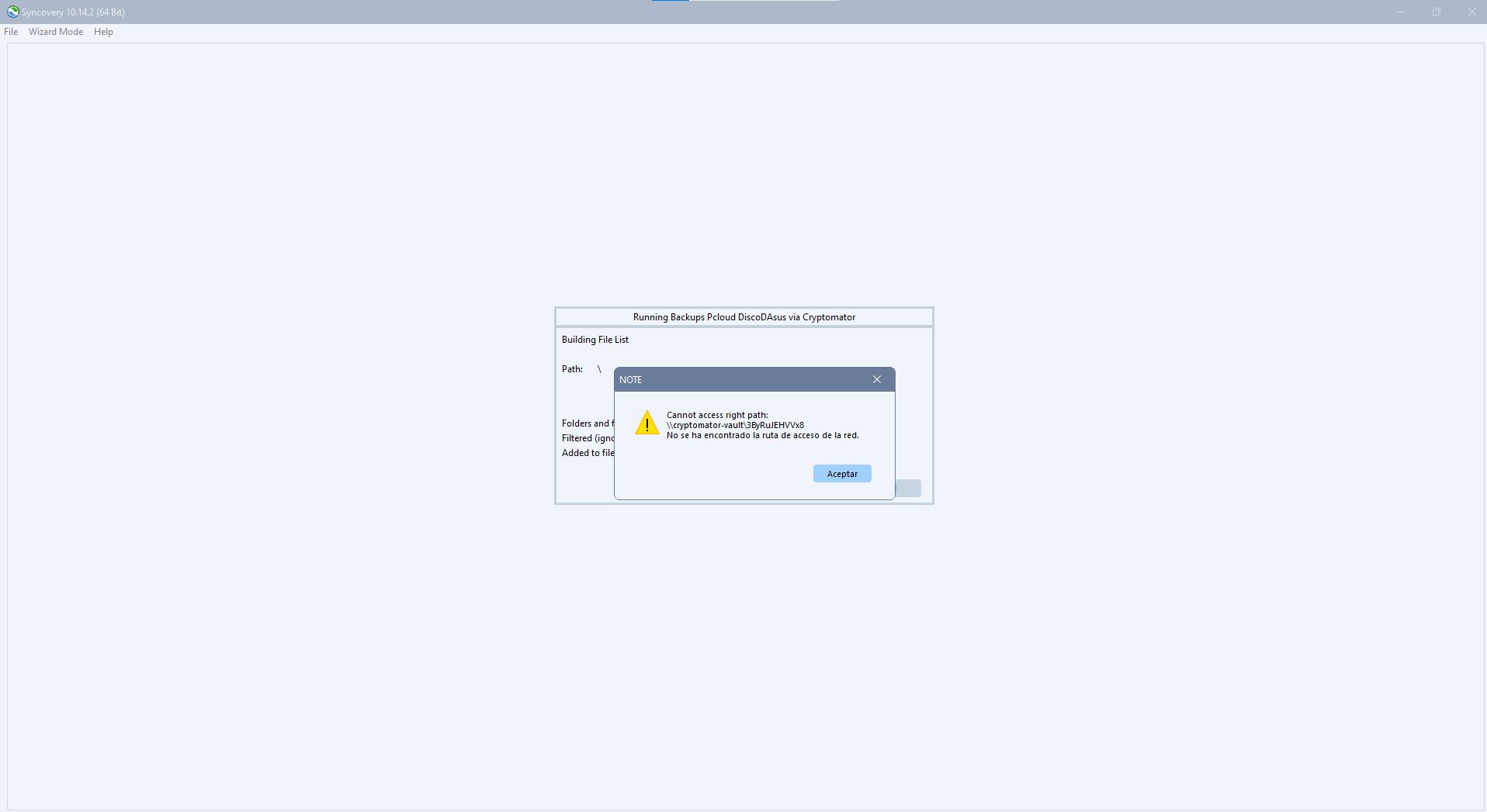

Still can not run profile

Posted: Tue Apr 23, 2024 8:18 am
your Cryptomator path is not correct.
It must have the name of the drive at the end. For example:
\\cryptomator-vault\Vc58iXN1nJvj\CryptoTest
So, after the part with the random letters and numbers, you must have a backslash, followed by the name of the drive.
This way, it works fine here.
In your case I think you need to add
\DiscoDAsus
at the end of the path.

Posted: Tue Apr 23, 2024 9:39 pm
by PaoloNB
Thank you Tobias.
It is working now. I thought the random numbers and letters were some sort of drive ID.
