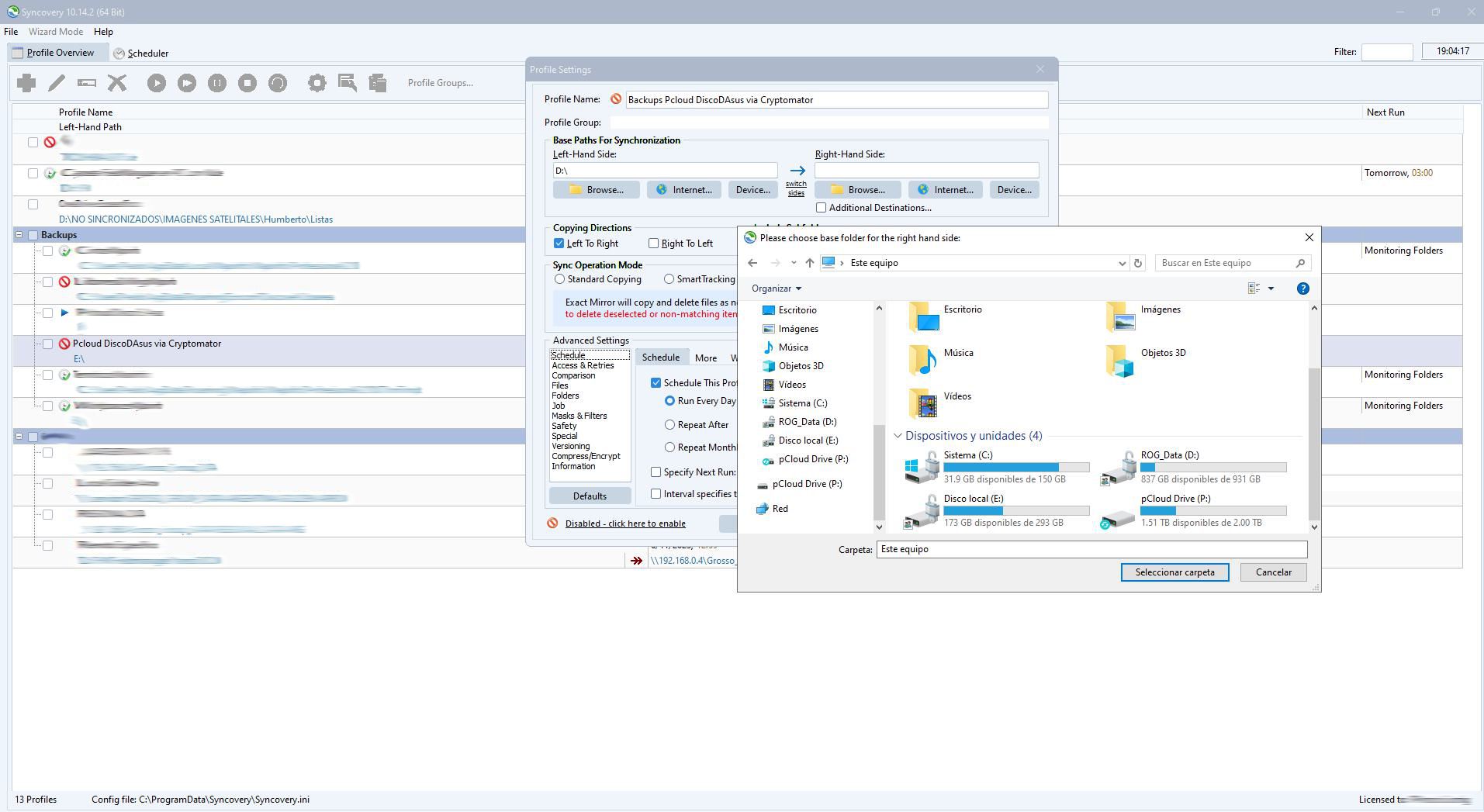

Cryptomator virtual drive unit is F:
This is what I see when I browse right side (note F: missing here):
Clipboard Image.jpg (205.39 KiB) Viewed 28038 times

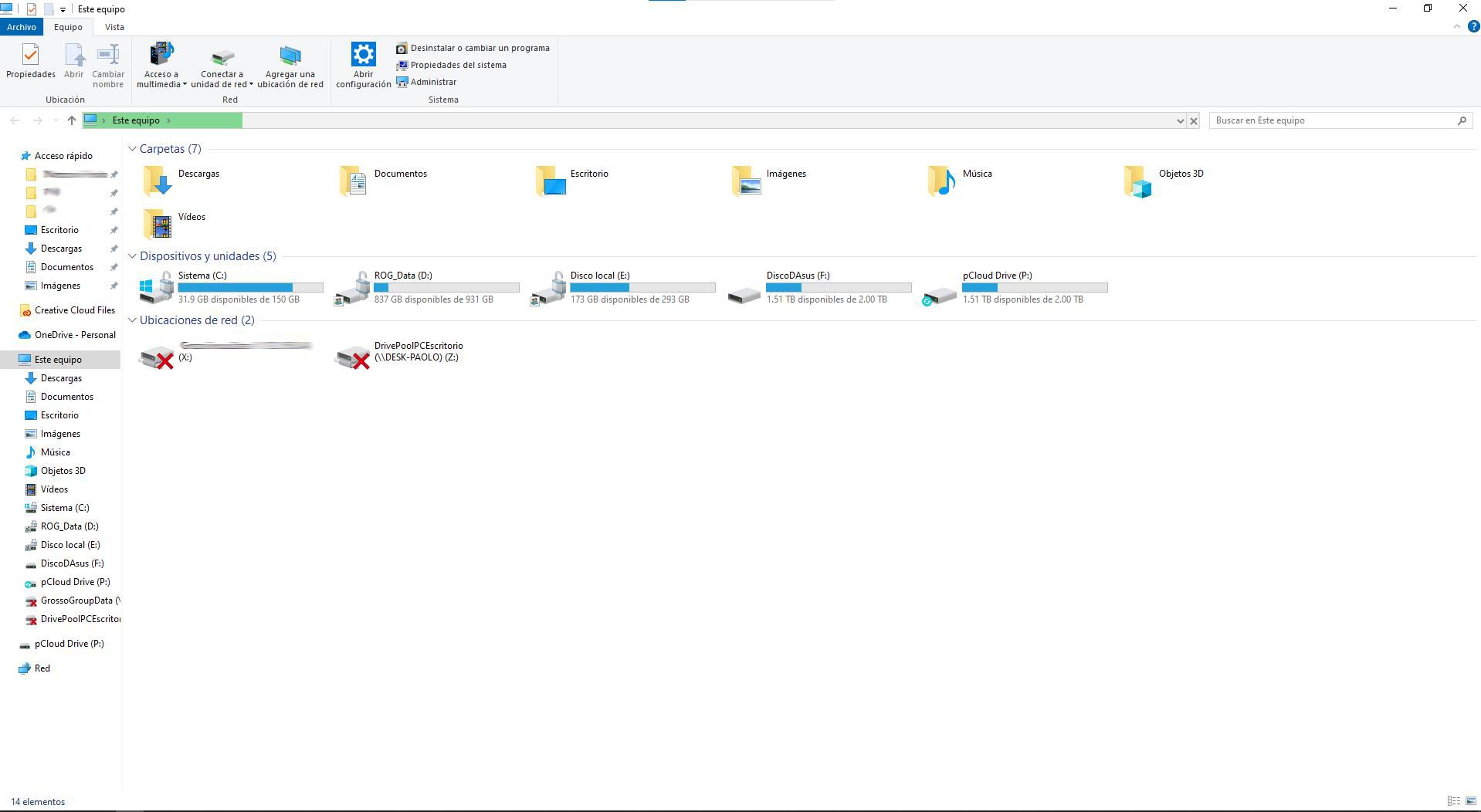

This is what I see in windows Explorer:
Clipboard Image (1).jpg (118.65 KiB) Viewed 28038 times

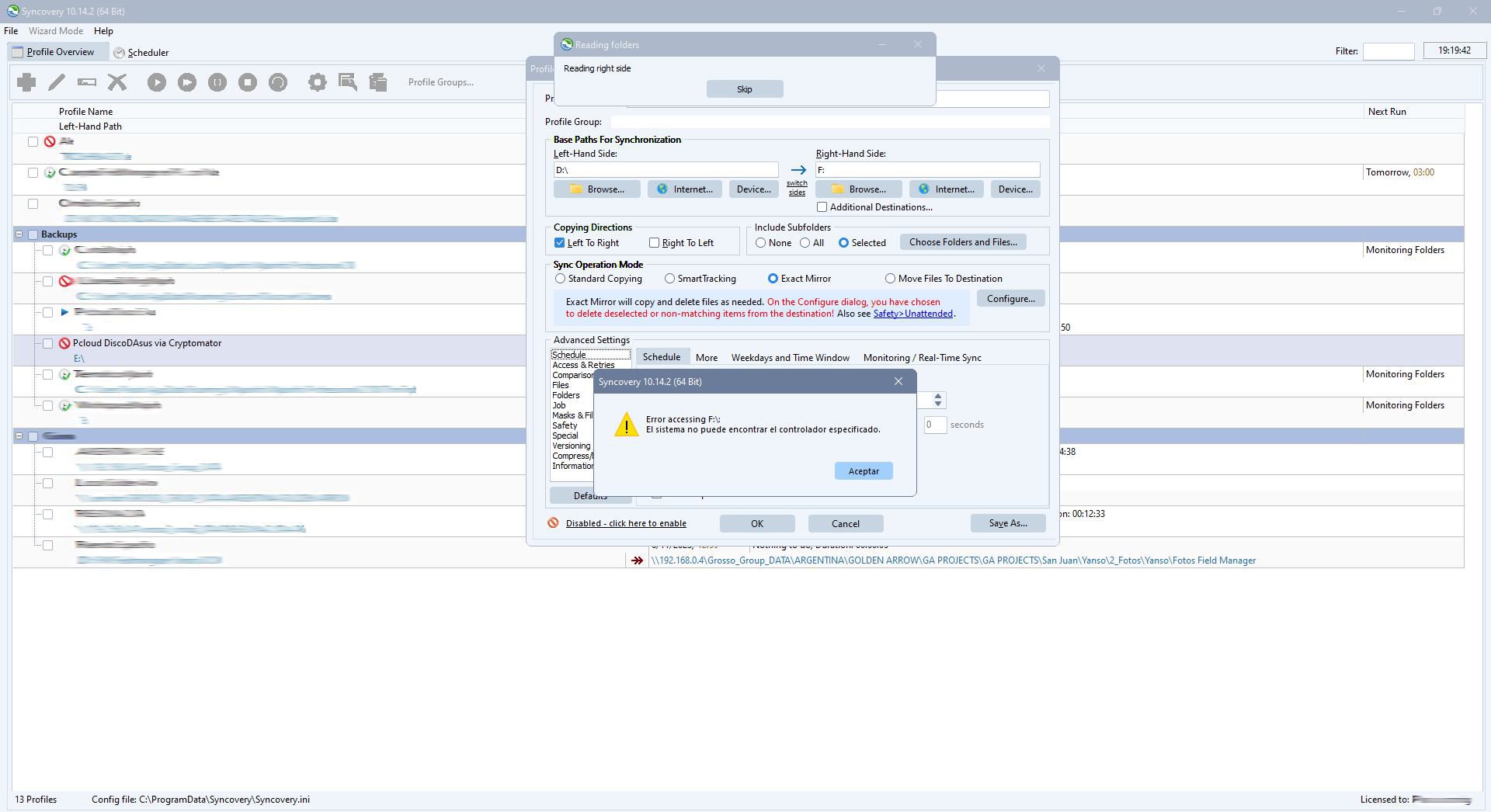

This is what I see if I just write the drive letter (F:) and try to select specific folders
Clipboard Image (2).jpg (193.7 KiB) Viewed 28038 times

Re: Syncovery does not recognize Cryptomator's virtual drive
Hello again,
I have installed Cryptomator myself now.
I have no problems working with Syncovery and the Cryptomator drive at all.
The interesting difference is that my Cryptomator drive appears as a network drive. It does have a drive letter, but Syncovery then suggests to replace the drive letter with the network path:
\\cryptomator-vault\Vc58iXN1nJvj\CryptoTest
Not sure why your drive F: appears as a local drive.

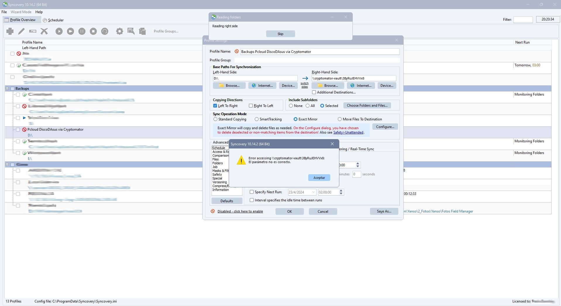

This is what happens when I try to select folders using cryptomator as a network drive:
Clipboard Image (3).jpg (196.19 KiB) Viewed 28038 times
ok, please don’t do that
type folder exclusions in the profile under
Masks & Filters -> Exclusions
For example:
\Archive
\Secret
\Videos\Archive

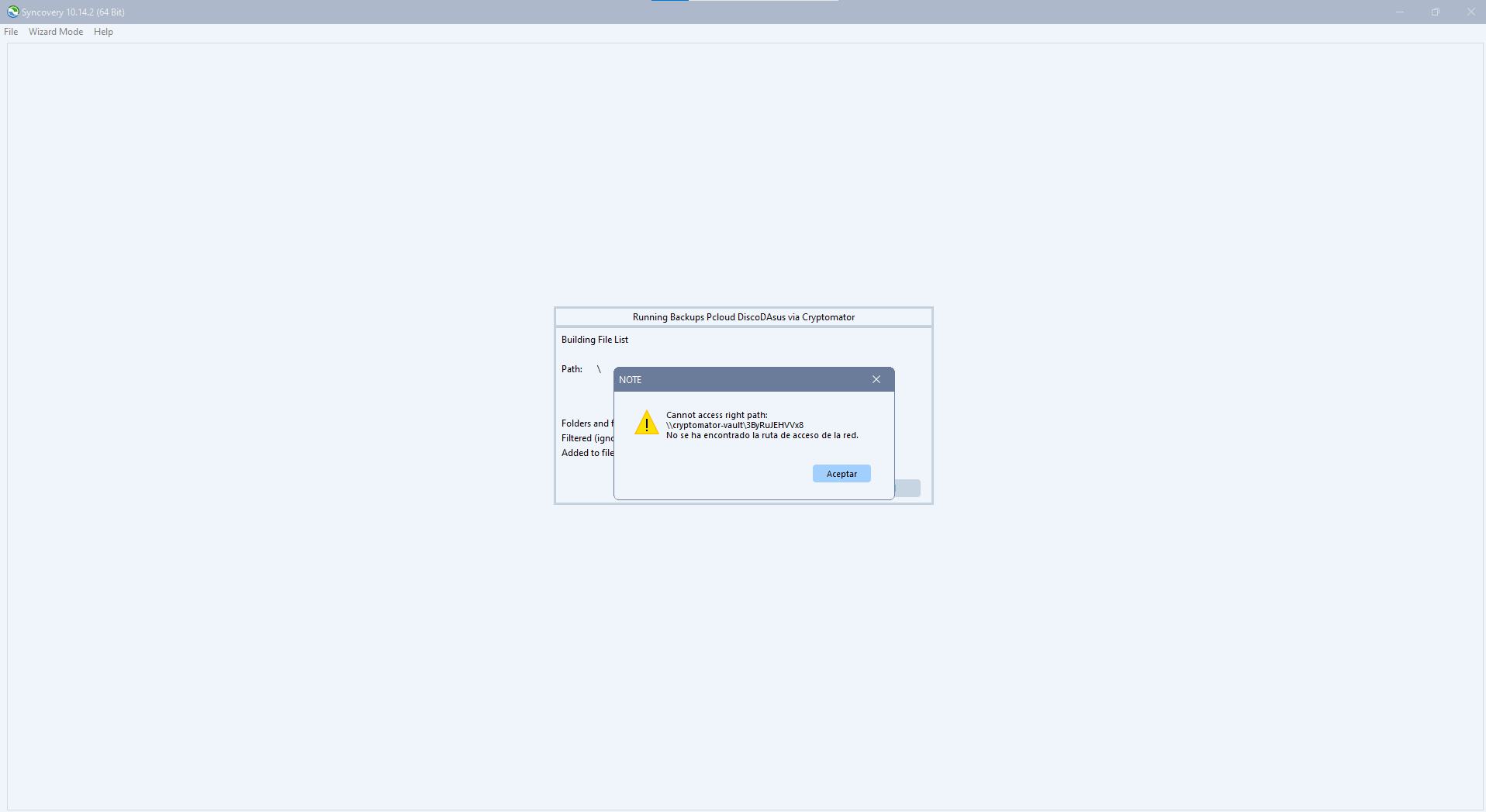

PaoloNB
Posts: 12
Joined: Mon May 24, 2021 4:14 pm
Post by PaoloNB »
Still can not run profile
your Cryptomator path is not correct.
It must have the name of the drive at the end. For example:
So, after the part with the random letters and numbers, you must have a backslash, followed by the name of the drive.
This way, it works fine here.
In your case I think you need to add
\DiscoDAsus
at the end of the path.
