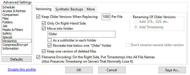

Re: Versioning
great.
I've set 1000 per file. So each time the original file (with the same name) is downloaded and the contents have changed,
it will download and put the existing file in the Older folder
- sync1.PNG (18.95 KiB) Viewed 14031 times
Re: Versioning
you might not need the checkmark "Filename Encoding" though. Please try with and without and see if it works as expected.
