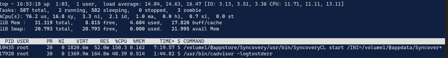

Hello, I just bought Syncovery and installed it on a Synology 1819+ with 32GB of RAM. Syncovery is generally unresponsive and is taking up excessive amounts of CPU. Originally it seemed OK because I was able to register it and also update the SSL certificate but now it basically doesn't load at all.
Screenshot 2025-07-15 175329.png (57.66 KiB) Viewed 163659 times
I've tried the version that runs as user Syncovery and also the version that runs as root. No difference. I tried reinstalling Syncovery, and also clearing out the residual configuration files and nothing seems to help. Happy to send any log files if needed. Thank you.
