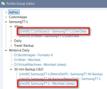

I have 2 profiles that I don't want to run at the same time. The profile names (taken from the 'Rename Profile' dialog box) are:
• p1 "[chn00] C:\(slctd,excl)--SamsungT7-L:\UserData" &
• p2 "[chn20] SamsungT7-L--Wombat (sleep)"
I have them in different 'Profile Groups' as shown in the below screenshot.
20250712 OnCanRunProfile.jpg (42.62 KiB) Viewed 50697 times

My problem is I'm still getting these 2 profiles running simulateously.

The scheduler starts p1 every 30 min at approx. 00:15/00:45 of the hour.
p2 is run as the third of 3 profiles that run in sequence started by the scheduler at 00:00 daily (I have them set up under 'Job' 'Execute after' with 'RUN PROFILE').
p2 takes anywhere from a few min to a few hours to run and I think the conflict happens every time p2 takes longer than 30 min. I never see the scheduler reporting "Not running job due to PascalScript".
