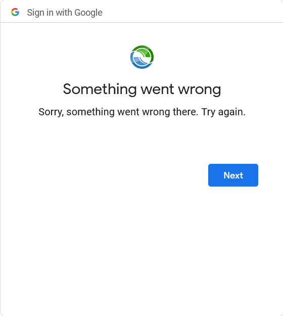

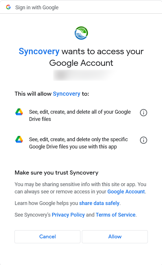

I'm trying to copy files from Google Drive to OneDrive. When I setup the profile and try to run it, it asks me to login to my Google Account, and then tells me that Syncovery will have access to Google Drive, and which I accept that, it tells me that "Something went wrong - Sorry, something went wrong there. Try again."
I've tried logging out and back into my Google Account, but the same message. What am I doing wrong?

which Syncovery version are you using, and on which type of computer?
Can you post a screenshot of the URL and message that you end up with?

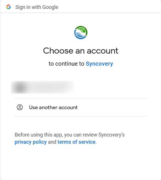

I'm using the trial version 9.47n build 390. 64bit. On Windows 10 Pro 64 bit.
I've attached the screenshots of the login process.

unfortunately this is an error on the Google servers, maybe you can contact Google support or just try again in a few days?
It works fine with my own Google Drive account. So far there haven't been any similar reports.
