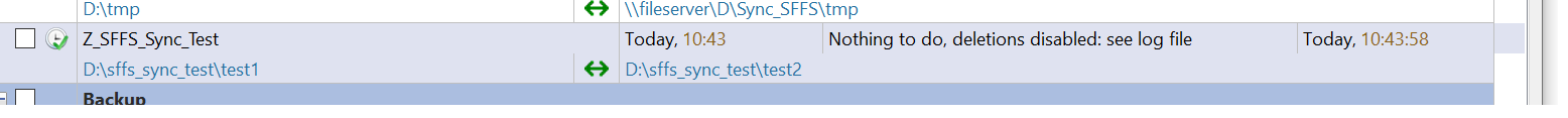

This is still a problem for me, so I tried version 9.0 (unfortunately, I have no other version between 9.0 and 9.47f available):
Created a new local sync profile with
- smarttracking for both sides,
- smarttracking settings for deleted files = Move into folder for deleted files
- Job scheduled every 1 minute
- Background scheduler globally on
- After both sides synced, I deleted a file on one side
- When running with 9.47f, the job was run (by background scheduler) with "Nothing to do", so there is NO indication that there are files to be deleted on one side and the folders are NOT in sync any more.
- When running with 9.0, the job was run (by background scheduler) with
So this is what I would expect (or even the result you posted in red).
I would really appreciate any support on this.
If you could provide the versions between 9.0 (9.40 from 12/2021 should be enough; I think this did not change earlier) and the actual 9.47f (are they available? I didn't find them...), I would be willing to locate the version when this changed.
If I can provide any other support, just mail me.
Sorry to bother you, but if you did not change anything intentionally, this behaviour will most probably the same in version 10 and this is a real showstopper for me.
Thanks!
