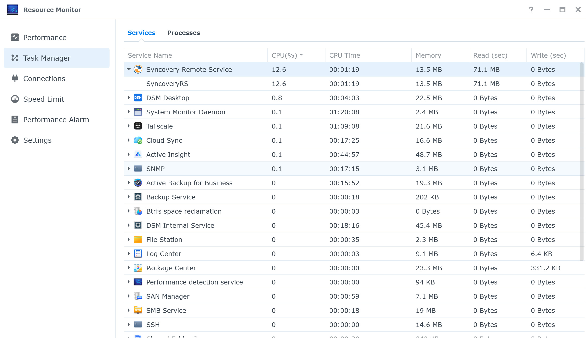

I am using Remote Service on my Synology NAS DS1621+ with RAID10 of 4 drives. Average read/write speeds are 300-400 Mb/s. I'm using block-level copying for syncing one 21Gb file between my NAS and laptop.
When the laptop is waiting for Remote Service to create MD5 checksums of a NAS side, I see that it uses just a tiny part of NAS resources.
The disk reading speed is near 72 Mb/s, and it uses just 13% of the CPU (please see the screenshot).
Is there any way to set Remote Service using more system resources and, as a result, finish building MD5 checksums faster?

- 2022-01-16-Syncovery-RS-NAS-resources.jpg (436.2 KiB) Viewed 28250 times
Re: Remote Service is slow
it has to calculate MD5 checksums, and that just isn't any faster. The rate is actually very good for MD5 calculation.
If your Syncovery job uploads to the NAS, you can avoid this by removing the checkmark "Right side uses Remote Service".
If you are downloading from the NAS, and you want block level copying, then you just need to live with the speed.
