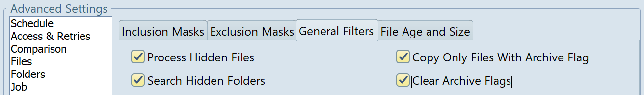

Another issue w/r to Syncovery: How can I set that Syncovery does not copy files already copied (by Syncovery) but deleted afterwards on right side?
Re: Access for iCloud/Foto and iCloud/Drive
Posted: Sat Jan 15, 2022 12:06 pm
you can use the SmartTracking mode for this, with otherwise default settings.
_________________________________________________________________________________________
Alternatively, if the source drive is a Windows drive (not iPhone or FTP/cloud), then you can use the Archive Attribute filters. To do that, you need to choose the two "Archive Flag" checkmarks under Masks & Filters -> General Filters in the profile.
