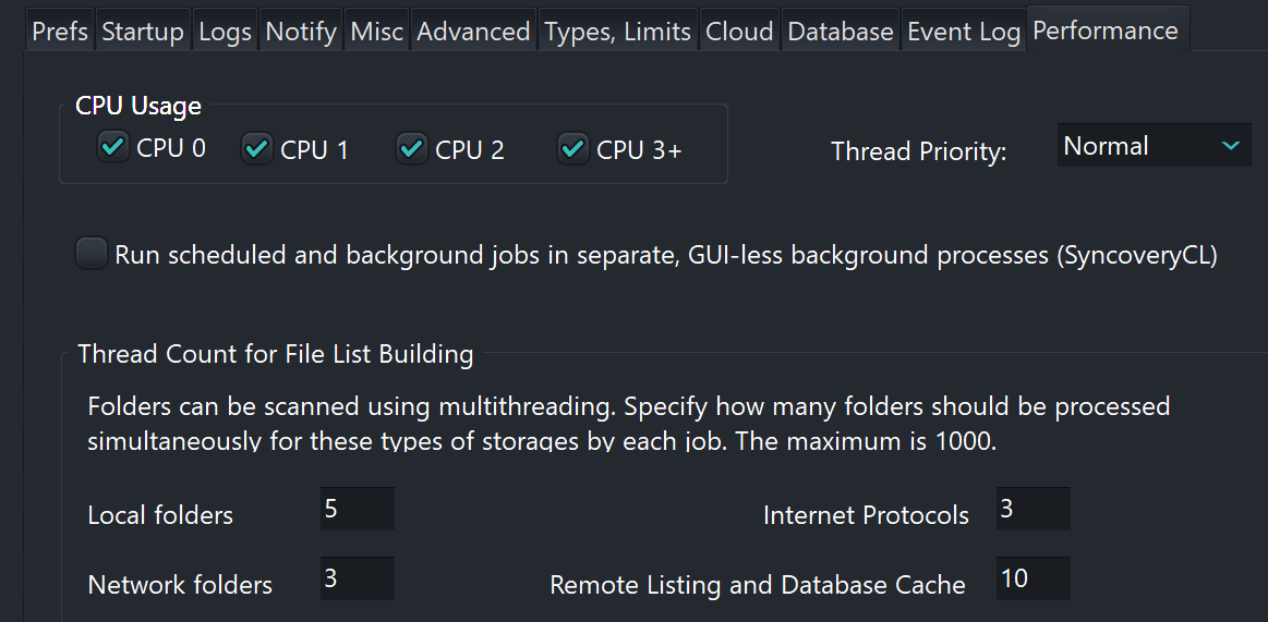

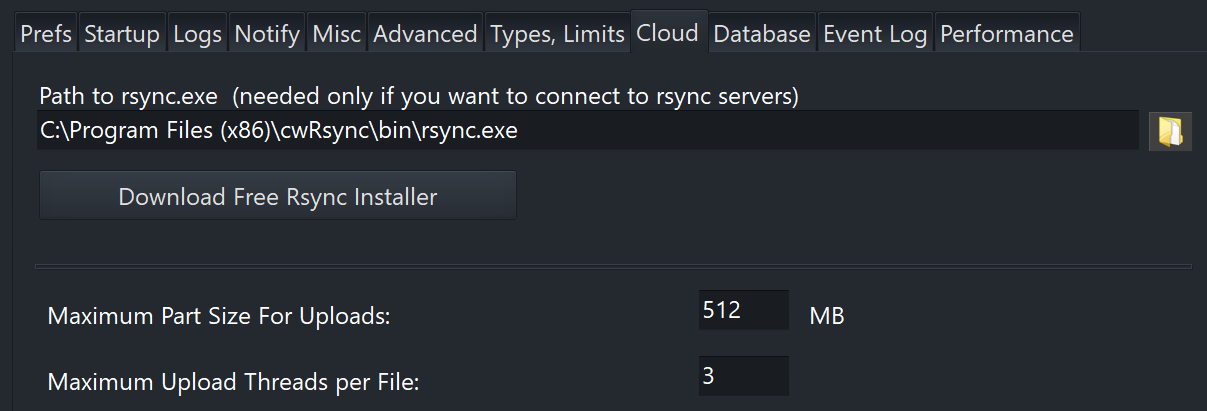

a bug has been identified that could cause Syncovery to reset some global program settings to 0 or 1, causing slow copying and no logging.
The new version 9.28a should fix this automatically, but if you are in doubt, please refer to the following screenshots for the reasonable default settings:
