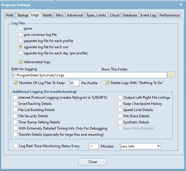

Actually, I have a similar issue with logging. Here are my logging options:
Here's an example of the detail I am getting for every file:

I thought I remembered a time when the log files were briefer than what I see now. Could the above detail be condensed into one line, much like the output from the command-line version??
Re: Logging too verbose
Posted: Sat Sep 18, 2021 2:50 pm
yes I will work on simplifying this.
