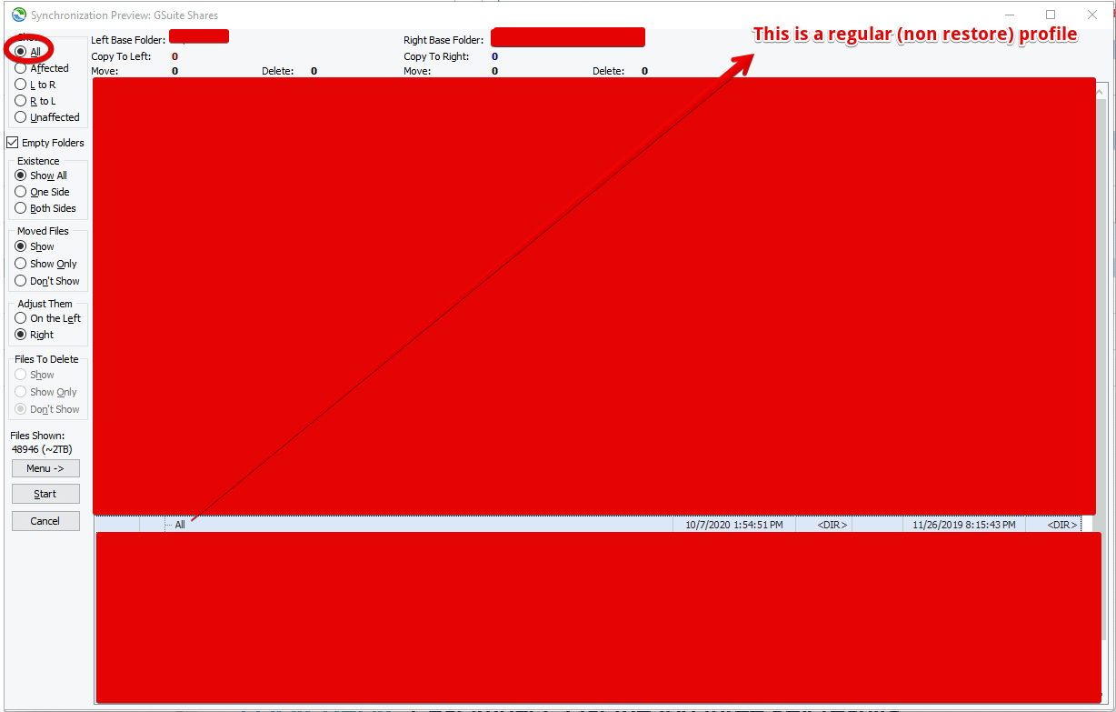

Hi Tobias. That's the kicker :( If I use a normal - non restore profile I can't see the files at all. I believe I discussed this option with you a while ago. I can only see all the files in the backup if I deselect this option and use a restore profile, otherwise not all the files appear on the backup set! This was the case already with Syncovery 8. :(
Notice here below that the 'All' folder is empty (no checkbox) in contrast with the restore profile which shows the files. I like the idea of the exclusion mask but the files are not existing anymore on the left side, plus would like to have more control on the deletions.

Can you send a few logs to support@syncovery.com, preferably unabridged, because based on these screenshot I really cannot say anything.

to be able to use the Delete menu items, you have to expand the folders and make sure that some files are visible and part of the selection.

To close the loop, it's not possible to mark for deletion when using a profile that copies right->left, but if you change to left->right and right->left at the same time the option is available. Thanks Tobias!
Re: Unable to delete folders from preview
Posted: Wed Oct 21, 2020 10:28 am
yes that was implemented as a safety guard, because a one-way sync may never modify the source side.
