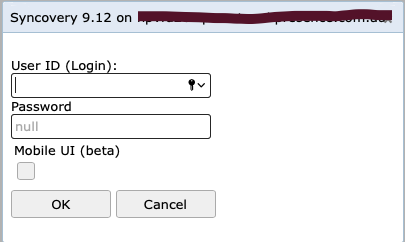

The install on Ubuntu worked. Thanks.
For expedience I used the handy option to run the web GUI without SSL by adding ?nossl=1 to the URL. That got me to a small login screen. It asks for a username and password. I didn't see anywhere to set those up. My Ubuntu user login doesn't work.
How do I set up the username and password for the non-SSL login?

the default login is
default
pass
It is mentioned many times on the download page.
When you're logged on, you can change it via the Program Settings button.

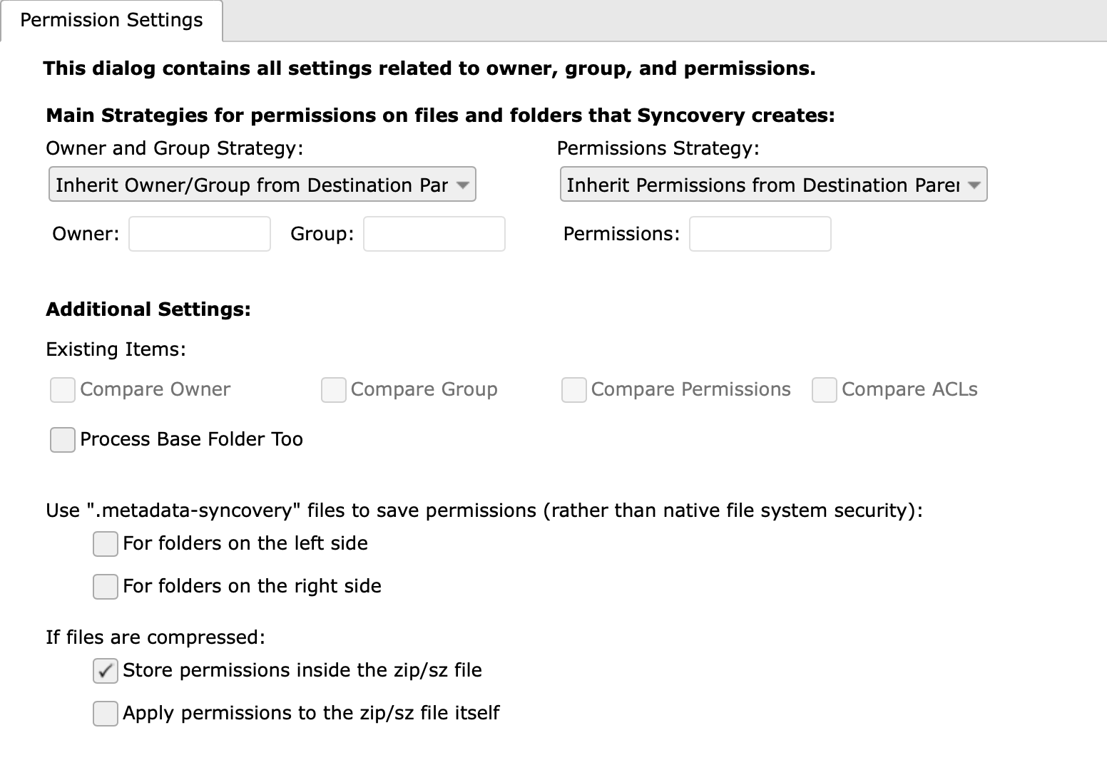

Ok, found the filters - great. I've almost finished the setup. A couple things remain - you said:
metadata, such as permissions, are also lost, unless you choose to "compress each file individually" and choose permissions and extended attributes to be included in compressed files
1. I found the compress-each file option. I chose zip but note the sz option looks better. Are there any downsides (with S3 say)?
2. I'm unable to find with certainty the option to "choose permissions and extended attributes to be included in compressed files". Do you mean the last two options in the Permissions (see screenshot)? If so, can you please share your recommended checkbox ticks for a backup to S3. (I suppose the question is largely about the second checkbox in both sections.)
Permission settings.png (161.53 KiB) Viewed 29701 times
