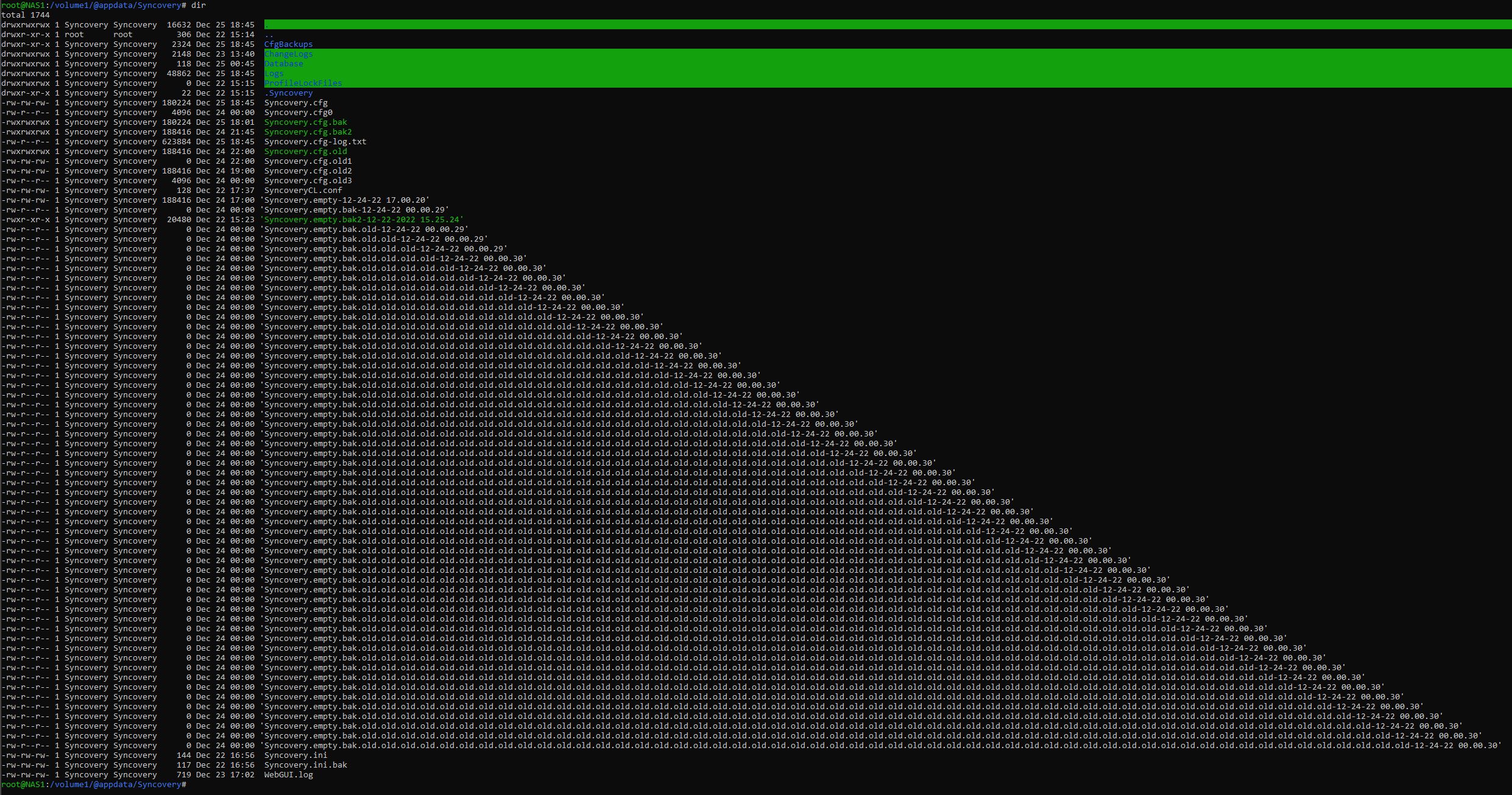

Re: Full uninstall ?
yes, it could be that your Syncovery.cfg file is corrupt. The full path is:
/volume1/@appdata/Syncovery/Syncovery.cfg
If you rename this file, Syncovery will use the previous backup. It might be sufficient to get it working. Unless the backups are also broken, in which case you may need to rename or remove the whole folder /volume1/@appdata/Syncovery. If you do that however, I would recommend installing the Syncoverey package again with DSM7 so that all the initialization is done properly.
- Posts: 20
- Joined: Sun Mar 27, 2022 7:55 pm
I ended up having to delete everything I could find. I figured at this point sinc eI have the profiles backed up, I may as well start with a clean slate.
rm -R /volume1/@appconf/Syncovery
rm -R /volume1/@appdata/Syncovery
rm -R /volume1/@apphome/Syncovery
rm -R /volume1/@appstore/Syncovery
rm -R /var/packages/Syncovery
Then a fresh install of latest version got it going again
I'll add these procedures to the operations manual for future reference. Appreciate the help!

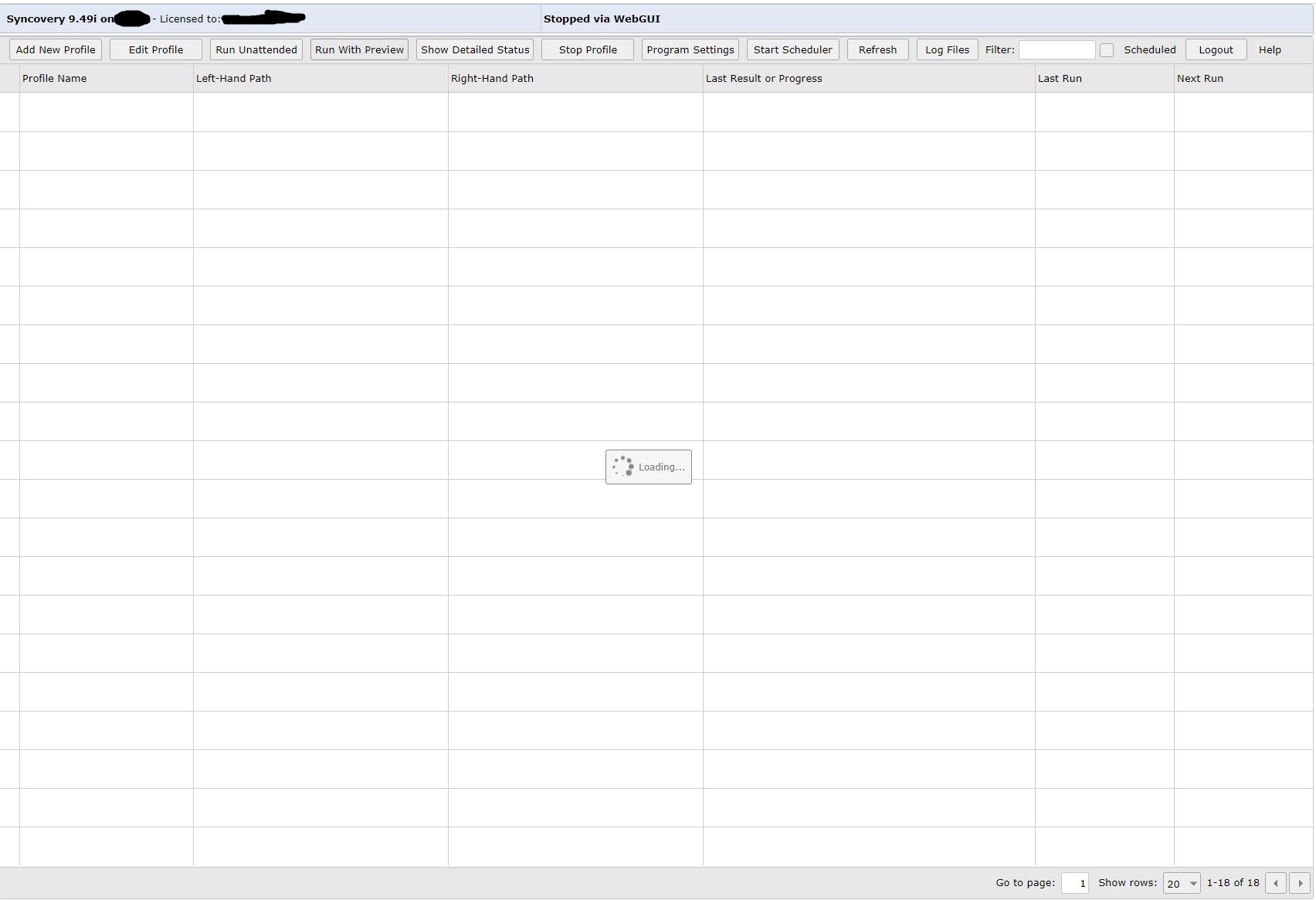

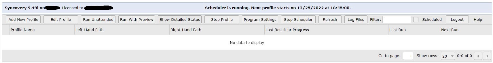

One other thing I have been experiencing is, sometimes when I edit an existing profile and save it, or simply just click the REFRESH button, the profile screens shows blank for all profiles and the "Loading" progress icon comes up. Usually the refresh happens right away. I let it sit at "Loading" for several minutes before finally closing the tab and logging back in, and then it comes up with a blank profiles screen "No data to display" (see screenshots)
After a number of attempts to log back in I eventually got all of the profiles displaying.
Then it happened again and this time it too a lot longer to get back to displaying the profiles.
I've also tried refresh.
Now it's back to not being able to save a profile - argh! All I did was enable the schedule on it. wtf - this is beyond frustrating
Maybe it's related to this rather constant Syncovery.cfg dance that I'm seeing in those logs in my prior post.
15:45:12 Copied /volume1/@appdata/Syncovery/Syncovery.cfg to /volume1/@appdata/Syncovery/Syncovery.cfg.bak (180224 Bytes)
15:45:12 Copied /volume1/@appdata/Syncovery/Syncovery.cfg to /volume1/@appdata/Syncovery/CfgBackups/Syncovery.cfg (12-25-22 15.45.12) (180224 Bytes)
So I poked around in /volume1/@appdata/Syncovery and there's a crapload of Syncovery.empty.bak... files (see attached SyncoveryEmptyBAK.jpg). I think this may be important. At some point that Syncovery.empty.bak.old.old.old..... filename length will be a problem,. The last entry is 253 characters long so I am thinking another .old will make it 257, and once we hit 256+ we've got a problem, Houston.
BUT, THOSE ARE ALL FROM YESTERDAY, NOT TODAY and it was running ok until just a little while ago. So maybe not
Still, whatever is causing that, doesn't look good.
