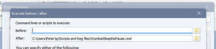

I have a simple cmd file that I want to run after a profile is finished so I entered the full path to the file (see screenclip) but it doesn't run.
It timesout with the following in the log file:
Executing: C:\Users\Peter\pj\Scripts and Reg files\WombatSleepNoPause.cmd
Executed C:\Users\Peter\pj\Scripts and Reg files\WombatSleepNoPause.cmd
The external command line took too long (Timeout: 120 sec).
The profile runs as administrator.
The cmd file runs ok if I try it outside of Syncovery.
20230130 execute after.jpg (30.94 KiB) Viewed 14669 times

the script is probably run in a different context, so you need to debug it.
For example, add logging.

What I meant with "context" is for example, if the scheduler runs as a service, it is a completely different environment from normal applications and some external tools may not work in that context.
You can compare a log file where it works agains one where it doesn't. Look at the top in the log file where it says "Running as".
But that's not the only difference. It could also be a Firewall or other things preventing the script.

When I run the profile Attended the cmd file executes ok - log says "Running as : Tornado\Peter (not Admin)"
When the profile is run by the scheduler service the cmd file timesout - log says "Running as : Tornado\Administrator (Admin)"
I can successfully run the cmd file outside of Syncovery - both as user Peter as well as Administrator.
