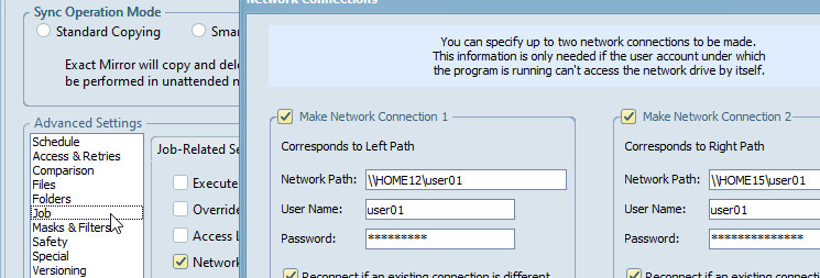

see attached, this is the section i am in quiring about, what gets entered here.
i think the windows 11 takes OUT the password, if the PIN gets aplied (ecample, local admin account)
thanks
thanks

network sharing not possible if PIN security is used, from what i am reading. This limits syncovery (and other programs) to share files across network.
PIN security is limited to local machine. This is of BENEFIT, it protects hard drives (and windows 11 now is encrypting drives behind the scenes, and if the correct pin is not entered, the drive is still encrypted).
There are ways to TURN OFF PIN (windows "hello" ) protection, and activate password, and thus access the network drive, but that then defeats the purpose of the PIN and you would have to keep switching back and forth in the network security permissions.
SO, that poses a problem in how to use syncovery to clone across home computers using previous SHARES of drives.
same limitations for any other use of the network shares; if oyu look at desktop, and select NETWORK, and see a connected home drive, same scenario, you cannot log into it to access a shared drive.
I don't know how to work around this, i've searched google, etc.
a workaround is to clone the home drive data (encrypt the upload) with syncovery to OneDrive, then download to the other computer.
anyway, this is what i've discovered.
nick
